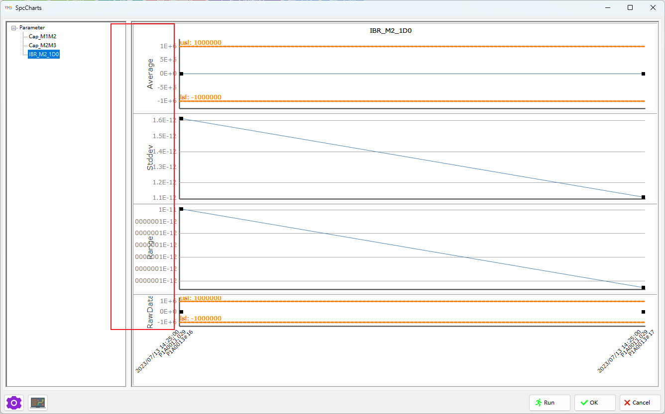

Post by coldwind » Thu Aug 31, 2023 5:38 am

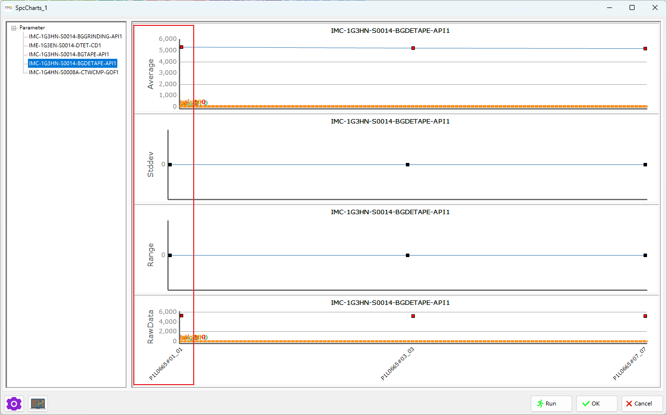

Question1:How do I find the maximum distance to the left of four graphs and set this maximum distance for all graphs. Or is there a better way to do this, so that if y is not aligned, the points on the top and bottom graph are not aligned
four chart.png (39.54 KiB) Viewed 68602 times

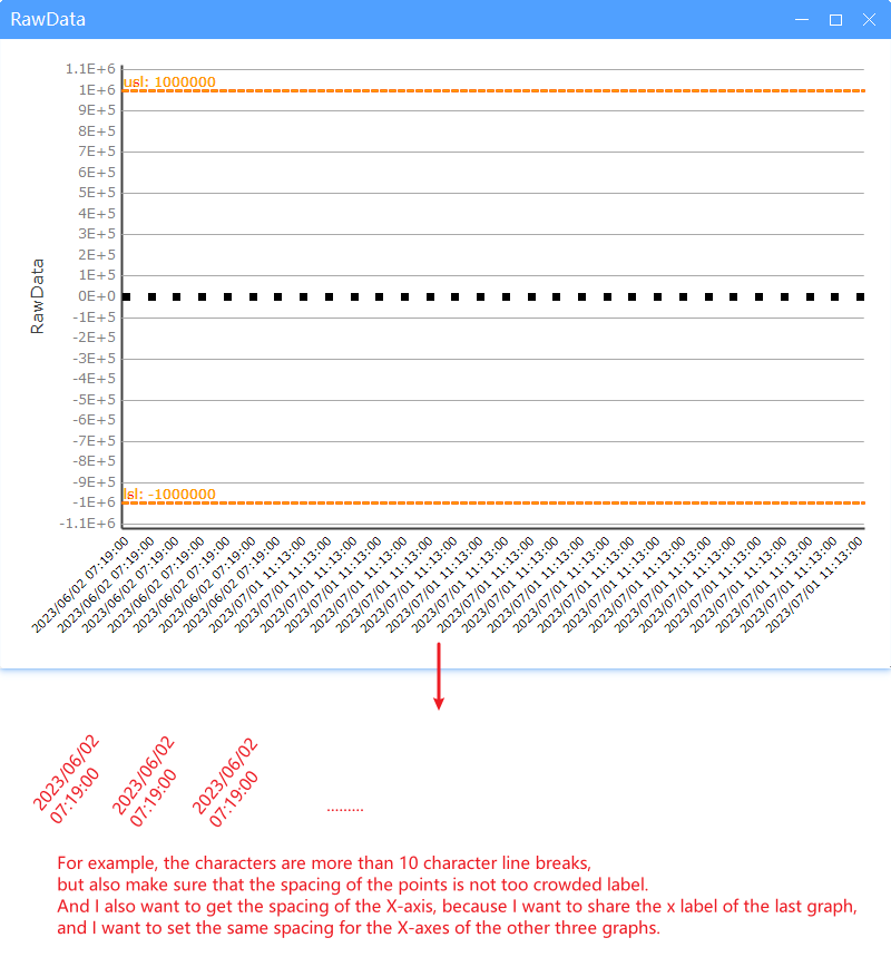

Question2:The X-axis label in the last figure is too long. I hope it can be displayed as a line wrap if it is too long, and the spacing between X-axis points and points can be widened
Line feed example.png (62.38 KiB) Viewed 68602 times

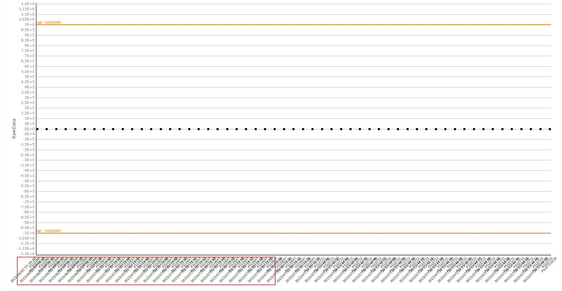

Question3:The X-axis names of the first five points in the red box are the same, I hope that each point can correspond to its own X-axis label, and then each point should have vertical lines, such as the gray line I hand-painted in the red box (it should be tchart.Axes.Bottom.Grid), I expect that each point has a corresponding X-axis. And they all have Axes.Bottom.Grid
Hope to reply as soon as possible, thank you !
A similar question is answered here.
Did you try Marc's suggestion here?
You can try using custom axes; a similar question was asked here.

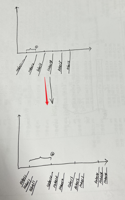

I want the label to wrap after 15 characters, but because the label is so long, it may need to wrap more than once. Therefore, it is also hoped that the spacing between points will increase synchronously according to the current number of newlines. The label spacing on the top of the hand-drawn sketch is smaller, and the label spacing on the bottom is larger. I wonder if it can be achieved?
Freehand drawing.png (197.82 KiB) Viewed 68576 times

Post by Christopher » Fri Sep 01, 2023 10:11 am
coldwind wrote:
Thu Aug 31, 2023 12:33 pm
Before adding the labels to the Chart, I think it would be easy to parse the label string and add in a '\n' character every 15 characters. TeeChart will recognize these line breaks and will adjust the spacing accordingly.

According to your suggestion, I have wrapped the X-axis label before adding the icon, but the label did not automatically separate and overlapped, as shown in the figure below
label overlap.png (36.96 KiB) Viewed 68515 times
The present situation is still not like the hand-drawn picture. When the width of the label newline becomes larger, the spacing between points does not automatically open. Is there any solution?

Question1:According to the example you gave, the following code is used. It is true that the four images can be aligned with the Y axis, but it does not seem to be set according to the maximum distance between the left and left borders of the maximum y axis.The Y-axis label is weighed down by the Y-axis title!
 List<int> yLabelLen = new List<int>
     avgChart.Axes.Left.MaxLabelsWidth(),
     stddevChart.Axes.Left.MaxLabelsWidth(),
     rangeChart.Axes.Left.MaxLabelsWidth(),
     rawDataChart.Axes.Left.MaxLabelsWidth()
 int yLabelLenMax = yLabelLen.Max();
 avgChart.Axes.Left.Labels.CustomSize = yLabelLenMax;
 stddevChart.Axes.Left.Labels.CustomSize = yLabelLenMax;
 rangeChart.Axes.Left.Labels.CustomSize = yLabelLenMax;
 rawDataChart.Axes.Left.Labels.CustomSize = yLabelLenMax;
avgChart、stddevChart、rangeChart and rawDataChart is four Tcharts.
The Axes.Left.MaxLabelsWidth() value for all four figures is 15,This is clearly not true!
The Y-axis label is weighed down by the Y-axis title!.png (38.6 KiB) Viewed 68512 times

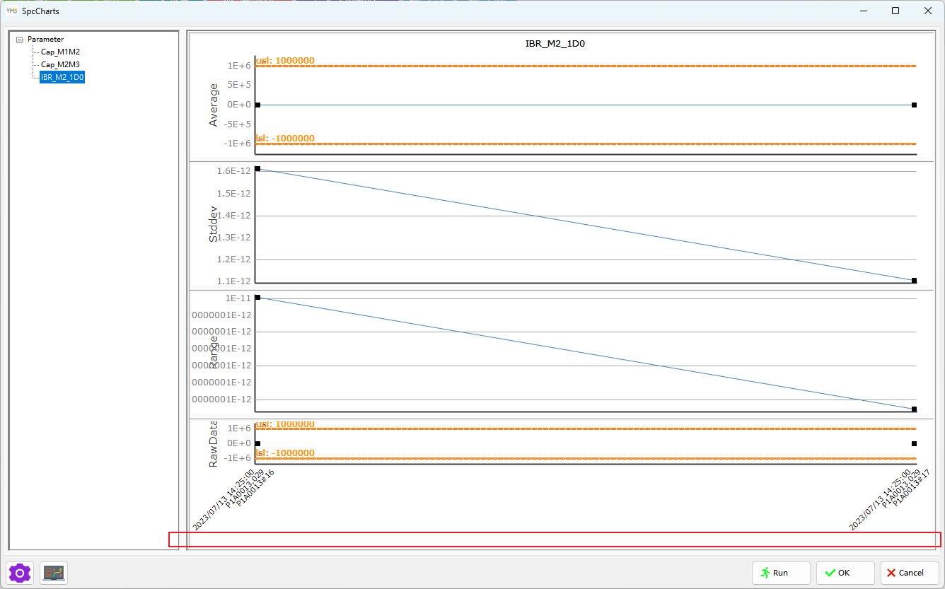

AnotherQuestion: x label try to attach the bottom border, which property can set this spacing?
x label .png (38.14 KiB) Viewed 68512 times
I'm not sure quite what the question is here, but a couple of things:
  • do you have FixedLabelSize set to false? e.g.
    tChart1.Axes.Left.FixedLabelSize = false;
  • you might consider using the GetAxesChartRect event for finer control over the size of the rectangle defined by the four axes. A simple example of it's use is here.
coldwind wrote:
Sat Sep 02, 2023 7:22 am
This is the job of the Increment property, e.g.
            tChart1[0].XValues.DateTime = true;
            tChart1.Axes.Bottom.Increment = Utils.GetDateTimeStep(DateTimeSteps.OneWeek);

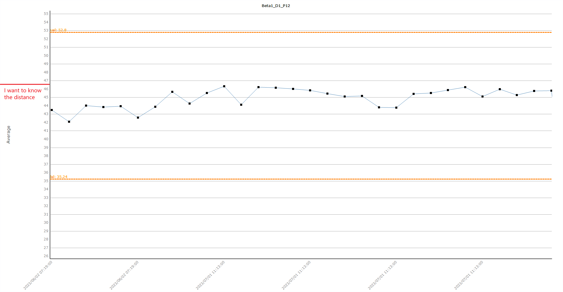

Post by coldwind » Wed Sep 06, 2023 9:24 am

How do I get the width of the Y-axis from the leftmost part of the current graph?As shown below
There are a couple of ways to do this, e.g.
            tChart1.Axes.Left.AxisPen.Visible = true;
            tChart1.Axes.Left.AxisPen.Width = 3;
            tChart1.Axes.Left.AxisPen.Color = Color.Red;
            tChart1.GetAxesChartRect += TChart1_GetAxesChartRect;
            tChart1.BeforeDrawAxes += TChart1_BeforeDrawAxes;
        private void TChart1_BeforeDrawAxes(object sender, Steema.TeeChart.Drawing.IGraphics3D g)
            MessageBox.Show($"IStartPos: {tChart1.Axes.Bottom.IStartPos}");
            g.Pen.Width = 3;
            g.Pen.Color = Color.Blue;
            g.Line(new Point(0, g.ChartYCenter), new Point(tChart1.Axes.Bottom.IStartPos, g.ChartYCenter));
        private void TChart1_GetAxesChartRect(object sender, Steema.TeeChart.GetAxesChartRectEventArgs e)
            MessageBox.Show($"GetAxesChartRect: {e.AxesChartRect.Left}");
We use 'tChart1.Axes.Bottom.IStartPos' because the Bottom axis is horizontal, therefore the IStartPos is a horizontal (X) value.
