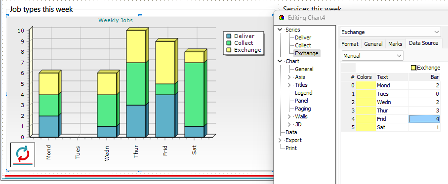

Post by andydyble » Thu Nov 23, 2023 3:51 pm
Ive added an image to show how I want it. Maybe its best to manipulate the datasource instead whihc is what I;ve done in the designer?
Andy

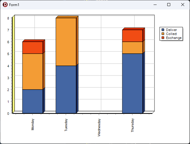

To do it automatically, you'll need to create a series for each of the "jobs" you have, and then you can loop the "weekDays" you want to track and search in your data structure and your series and add the value for matching that weekDay, or a zero if none.
I created a simple example with a couple of dirty records to emulate your data structure. This part should be accommodated to your datasource.
Then, I'm creating the series and looping the weekDays as indicated above.

And this is what I get with the example above:
