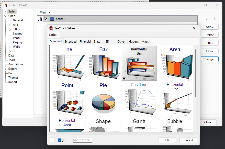

Hi
I cannot work how to change my chart to a Horizontal bar chart. I've looked at all the Properties and looked the design time chart but can't anything.

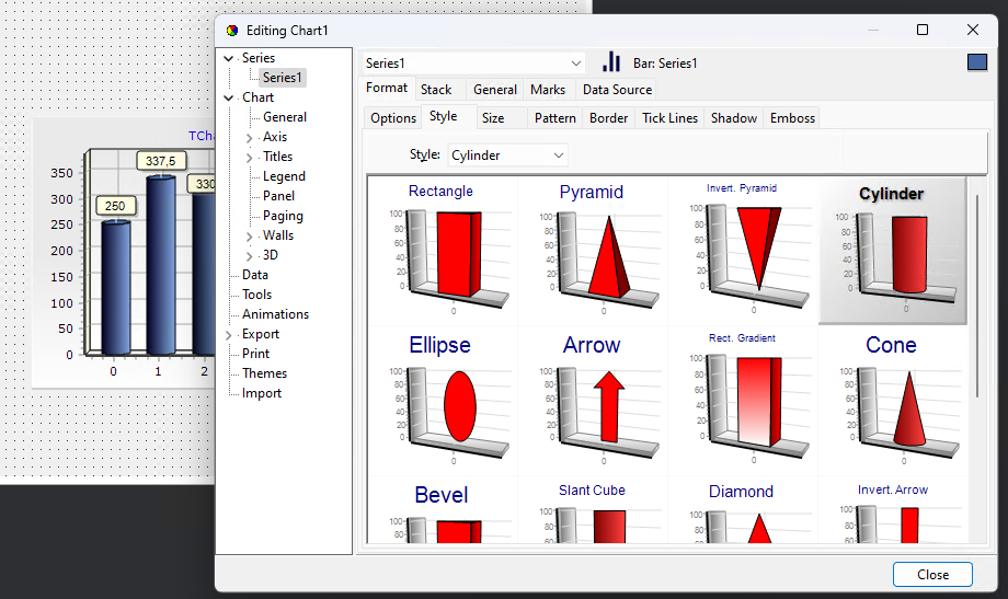

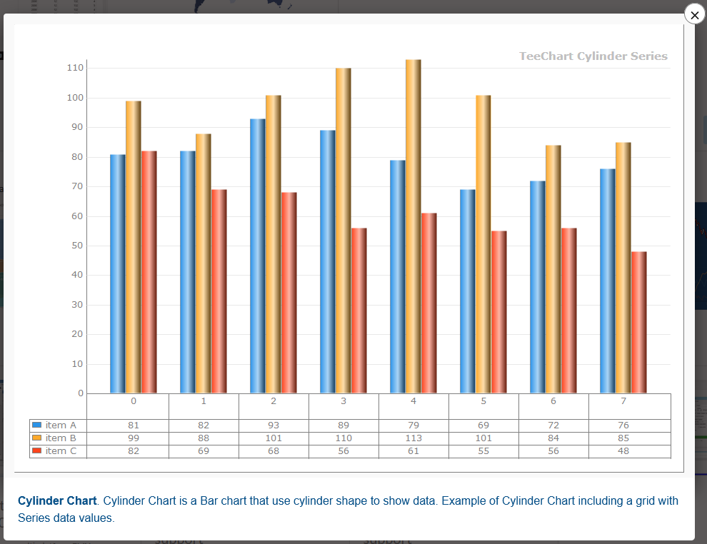

Also, in the marketing info on the website there are and Cylinder charts, which look great but I can't see anything like that either.
You should select the Horizontal Bar series in the gallery either with the "Add" or the "Change" button:
Do you mean this one?
You can set the Cylinder style at design-time as follows:
