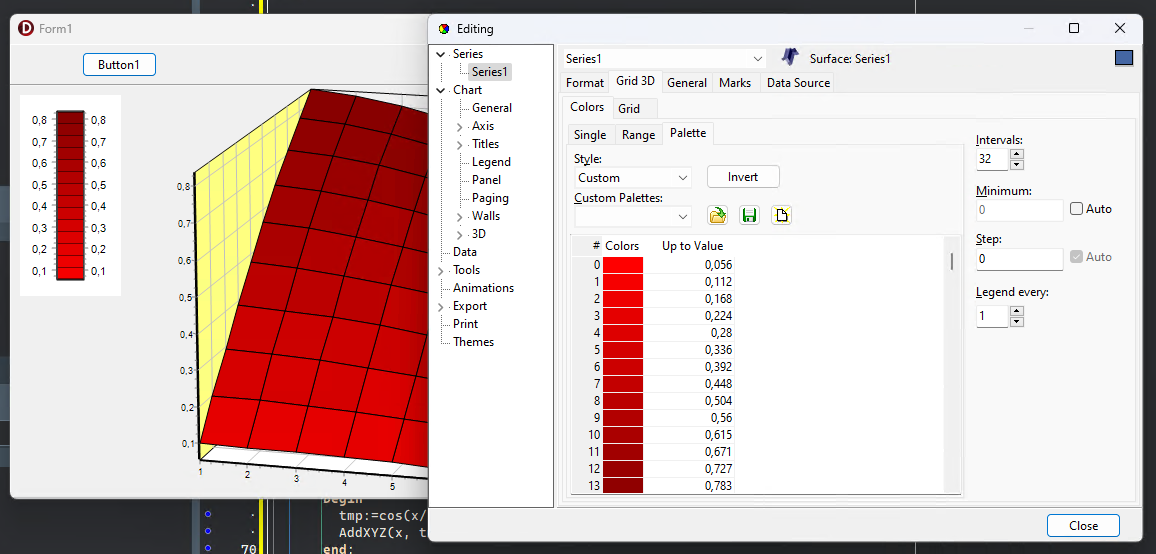

I am trying to customize a ColorGrid series in order to display appropriate colors corresponding to my input values. I have checked the link you provided
Yeray wrote:
Thu Jan 25, 2024 7:52 am
I'd suggest you to take a look at the ColorGrid example in the Features Demo shipped with the binary installer.
Here some screenshots changing some of the properties you mention:
viewtopic.php?f=3&t=16044&p=71207#p71207
Among the pictures you provided in the link above, I see in the tab "Grid3D -> Palette -> Colors, you set Style=Custom, Custom Palettes = Rainbow and you have underneath 3 columns: index, Colors, UptoValue. You have different values -0.82, -0.754, -0.688, etc. corresponding to different colors on the left hand.
However, in my case, I cannot modifiy the values on the right hand: they are all 0.537 and I don't know how to change them.
In addition, I would like to know how to do this by code, especially in the run time.
Thank you for your support.

Re: How to get TColorGrid scrolling
Post by Yeray » Wed Feb 07, 2024 2:41 pm
Hello Sciensoria,
Have you seen the example here?
It shows hot to create a custom palette.
