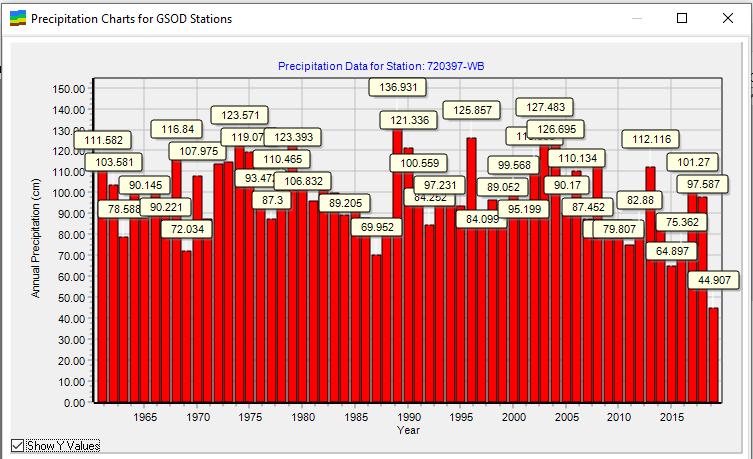

Hello
I have been trying to format the data labels to only display 2 decimal digits. The attached screenshot displays 3 decimal digits.
I have tried a number of things, including
Chart1.Series[iseries].AddXY(QYear, QVal, Format('%7.2f',[Qval])); //this will also change the Xaxis label (XLabel);
Chart1.Series[iseries].Marks.Items[iPoint].text.Add(Format('%7.2f',[Qval])); // this adds text to the existing label; even if cleared.
The values format for the left axis is set to 2 decimals, but this does not seem to affect the data labels.
LeftAxis.AxisValuesFormat := '0.00' ;
Please advise.
Re: Formating of Data Labels in bar chart
Post by Yeray » Tue May 07, 2024 6:19 am
Try with the ValueFormat property of the Series:
Chart1.Series[iseries].ValueFormat:='#,##0.00';  // '#,##0.###' by default
Post by Zach A » Wed May 08, 2024 1:51 pm
That worked. Thank you very much for your help!
