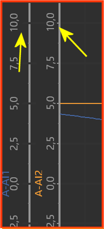

In an project I am using a custom axis for each series. There is a 'huge' distance between the text and the axis (picture: left arrow).
The right side of the picture shows the desired result (I'd faked this by editing the picture).
How can I configure the labels' distance, please?

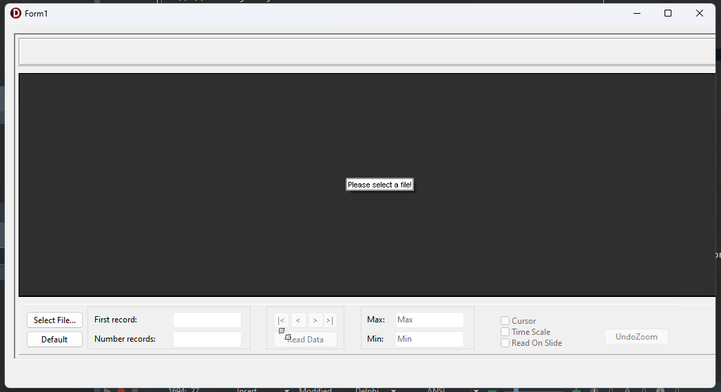

Also, I'd like to use the ScrollPagerTool to have an overview of data loaded from an file.
Setting up the Chart and the Scrollpager, loading data from file and assigning the value to series (TFastLineSeries) works.
On initialisiation, before data is loaded, the chart gets some basic configurations. Also the scrollpager is created and attached to the chart. The scrollpager is hidden until data is loaded, series were created and 'filled' with the data, and (custom) axes were configured.
After that the Scrollpager is set to be visible and ScrollPagerTool.SetUpScrollPager is called.
I've also tried to 'Invalidate' the main chart, if there is something that needs to be pre-calculated, that the scrollpager relies on.
Scrolling the Scrollpager's colorband and modifying the 'viewport' by changing the colorband's start/endline works, so that the (main) chart mirrors the scrolling etc.
But... the series from the chart that is assigned to the scrollpager is not drawn to the scrollpagers subchart.
The scrollpager is 'empty', its subchart has a bottom axis, but there is no series draw, nor a left axis is drawn.
I've tried a) or b)
  • a) ScrollPagerTool.Series := ViewChart[0];
    b) ScrollPagerTool.AddSeries(ViewChart[0]);
You can play with the Texts.MarginToAxis property to find what fits your needs. See the example below.

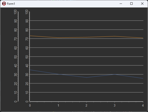

I'm not sure to understand what do you mean with "By clicking a series in the chart the grid is 'relocated' to that series".
However, here you have a simple example with two series, each one with its custom vertical axis. When adding them, I hide all their Grid. Then, at the end I only have to make sure to move one to the left and show the grid of the other one.
uses Chart, Series;
var Chart1: TChart;
  procedure AddSeries;
  var i: Integer;
    with Chart1.AddSeries(TFastLineSeries) do
      with Chart1.CustomAxes.Add do
        CustomVertAxis:=Chart1.CustomAxes[Chart1.CustomAxes.Count-1];
        SetMinMax(0, 100);
        LabelsFont.Size:=10;
        LabelsFont.Color:=clLtGray;
        LabelsAngle:=90;
        Texts.MarginToAxis:=-70;
        Axis.Width:=2;
        Axis.Color:=clLtGray;
        Grid.Hide;
      Add(25+Random*50);
      for i:=1 to 4 do
        Add(YValue[Count-1]+Random*10-5);
  Chart1:=TChart.Create(Self);
  with Chart1 do
    Parent:=Self;
    Align:=alClient;
    Color:=$2f2f2f;
    Gradient.Visible:=False;
    Walls.Hide;
    Legend.Hide;
    View3D:=False;
    MarginLeft:=20;
    Axes.Bottom.LabelsFont.Size:=10;
    Axes.Bottom.LabelsFont.Color:=clLtGray;
    Axes.Bottom.Axis.Width:=2;
    Axes.Bottom.Axis.Color:=clLtGray;
    Axes.Bottom.Grid.Hide;
  AddSeries;
  AddSeries;
  Chart1.CustomAxes[0].Grid.Show;
  Chart1.CustomAxes[1].PositionPercent:=-10;

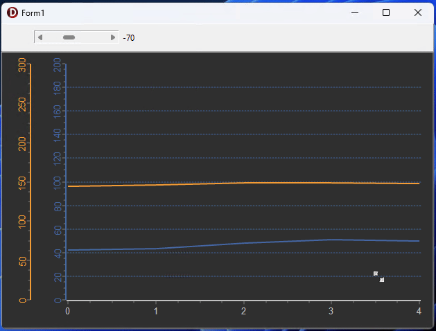

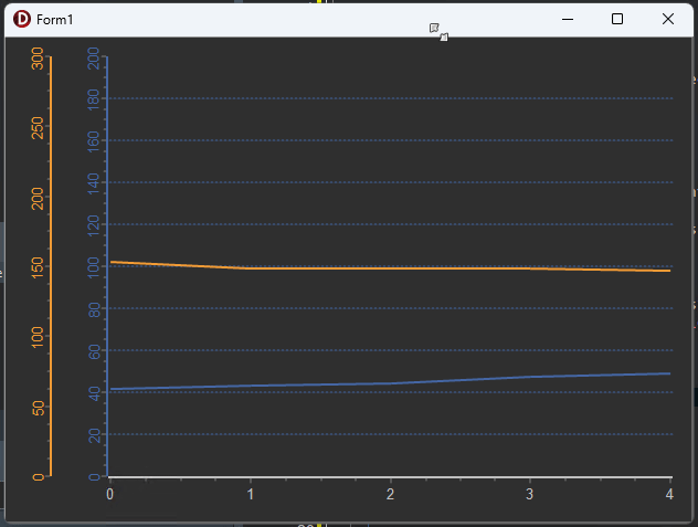

In my picture "grid.png" you can see that the axes do not use the same Min/Max settings -- the axes are scrollable independently.
In the picture the user moved the left axis a bit down, so that the ticks of the left axis are no more aligned to the ticks of the other axis.
If all axes had a grid, it would be very confusing because of multiple grid lines for e.g. 0.0 ticks at different positions for several axes.
So, there is exactly one grid and this is drawn for the ticks of one series and its corresponding custom axis.
The user can click a series in the chart and a callback 'OnChartClickAxis' shows the grid for that series, and hides the grid for the (all) other series.
If I understand your example correct, the grid is drawn for the right-most axis and 'all' other axes are shifted to the left, so that the grid lines to the right of the right-most axis do not interfere with lines, texts of axes to the left of the right-most axis. (Woah, that's confusing ;) ).
Ok, that would be a work-around to rearrange the axes each time the user clicks a series (move the 'grid axis' to the right). But I'd prefer a solution that keeps the order of the axes (e.g. data of several analog input from a data acquisition system Ai0, Ai1, Ai2,...)

Ja, that's what I want, changing the grid (show/hide for axes) works already.
The problem: In my chart the horizontal lines of a grid are painted starting directly from the clicked axis.
In your video/example: the 'orange' horizontal grid lines start at '0.0' position of the bottom axis.
In my chart the 'orange' horizontal grid lines start at the position of the orange axis.
That confuses me...

I've added a scrollbar to test different Texts.MarginToAxis values and it seems to work fine for me here:
  SBLabelsMargin.Min:=-100;
  SBLabelsMargin.Max:=400;
  SBLabelsMargin.Position:=-Chart1.CustomAxes[0].Texts.MarginToAxis;
  LLabelsMargin.Caption:=IntToStr(Chart1.CustomAxes[0].Texts.MarginToAxis);
procedure TForm1.SBLabelsMarginChange(Sender: TObject);
var i: Integer;
  for i:=0 to Chart1.CustomAxes.Count-1 do
      Chart1.CustomAxes[i].Texts.MarginToAxis:=-SBLabelsMargin.Position;
I've tested the same project at 175% and it also seems to work fine for me here.
If you still find problem with it, please arrange a simple example project we can run as-is to reproduce the problem here.

Attached is an (ugly) but stand-alone working example of the 'ViewChart' (TChart) that is normally embedded in a big application with lots of dependencies.
Please click the button 'Default' (bottom-left corner) to add random data to the chart.
You can scroll the axes, and click series in the chart. Other features not tested in this example.
(I know the code is a mess, still evaluating/learning the TChart software.)
In 'OnChartClickSeries' I am adding a constant to the current margin. Each time a series is clicked in the chart it should increase the distance between the text and the axis.
The value of the property reflects the changed value, but the graphics do not.
Observing the i variable shows, that the value was remembered each time a series was clicked. The actual distance painted in the chart is always the same, it does not increase.
procedure TFrameViewData.OnChartClickSeries(Sender: TCustomChart; ASerie: TChartSeries; ValueIndex: Integer; Button: TMouseButton; Shift: TShiftState;
   X, Y: Integer);
   // test
   var
      i: Integer;
   i := ViewChart.CustomAxes[0].Texts.MarginToAxis; // first time=10, next time=30, next time=50, etc
   ViewChart.CustomAxes[0].Texts.MarginToAxis := ViewChart.CustomAxes[0].Texts.MarginToAxis + 20;
   i := ViewChart.CustomAxes[0].Texts.MarginToAxis; // 10+20=30 , 30+20=50 , ...
   Inc(i); // breakpoint
   ViewChart.Update; // invalidate // repaint
Also you can see that the lines of the grid always start at the left most axis.
Thank you for your patience with me.... ;)

2) Grid
The horizontal grid lines are drawn starting at the left most axis, not at the 0.0 position of the bottom axis. I do not know how to fix this!
In the example project, clicking a series in the chart 'relocates' the grid to the axis of the clicked series. To see that, you need to scroll one of the axis a bit, so that e.g. the 0.0 ticks are no more on the same height.
Clicking a series changes the grid corresponding to the axis ticks of the clicked series.

2) Grid
I see you are moving the Bottom axis StartPosition at around line 912.
ViewChart.BottomAxis.StartPosition := ScalePosFactor * (NumScales - 1) + ScalePosOffset;
That calculation gives 5 so the bottom axis starts at 5% of the chart rectangle.
You have your custom vertical axes at positions 1% and 5%.
That's why the bottom axis starts exactly aligned with one of your vertical axes.

3) Scrollpager
To enable the example's ScrollPager tool:
a) Uncomment the directive {$define USE_SCROLLPAGER} at the top of SetupViewData.pas
b) In TFrameViewData.InitPanel make the Scrollpager visible: //ScrollPagerTool.Visible := False; // hidden until a file is selected
The Scrollpager in the example does not display the graph of series. In a very (very) simple example with a chart, a series and a Scrollpager the scrollpager's subchart displays the data of the series of its main chart.
But in my project it does not -- I do not understand the reason for that!
There's a record 'TSignal' that acts as an intermediate layer between TChart series and channels of a file. Files can have dozens to hundreds of channels, but the TChart should display only a very limited count. For each channel of the file there is a is a record element, if the channel should be displayed in the chart, the records 'Series' member is non-nil.
Assigning a series that's displayed in the chart to the scrollpager works (I think), because moving/dragging the colorband of the scrollpager works, but the scrollpager does not paint the signal/series graph.
I see you are assigning the vertical axis of the Signals[0] to the subchart at InitFile. Instead of that, just make sure the VertAxis of the series in the scrollpager is set to aLeftAxis:
   // set left axis of series of main chart to be used as left axis of series in Scrollpager's sub chart
   // ScrollPagerTool.Series.VertAxis := ViewChart[0].VertAxis;
   // ScrollPagerTool.SubChartTChart.Axes.Left.Assign(Signals[0].Serie.GetVertAxis);
   ScrollPagerTool.SubChartTChart[0].VertAxis:=aLeftAxis;  // <--- Try this
   ScrollPagerTool.SubChartTChart.LeftAxis.Visible := True;

Perhaps it is easier to describe what I want to achieve instead of trying to repair my constructs.
In another project I draw it all by myself with direct2d, the series' data, axes and their texts and minor/major ticks, cursors, titles etc.
The main concept is that the area in which the signals (aka series) are displayed only takes up the space left by the dynamic number of axes. So, if a file has four channels, each signal in the chart has one axis. The four axes are either to the left side or the right side (or mixed eg. 2 left, 2 right) of the painting area.
The "signal area" takes the rest: Its rectangle's left and right side is the height of the custom axes (Y), the rectangle's top/bottom is the width of the time scale (X, 'bottom axis').
So, inherently, the first data point of a signal (series) is always painted some pixels (borders, padding, margins etc) to the right of the right most axis (if all axes are left), because the Minimum of 'my' X axis starts on the left side of the rectangle of the "signal area".
So are the horizontal lines of a grid.
I wanted to mimic that concept by moving the custom axes: first signal's (series) custom axis is the left most with some margin (ScalePosOffset = <some value>) and the "ScalePosFactor" set to zero.
The next signals' (series) axes' positions were calculated with formula : Factor * X + Offset.
Now, I thought, that I can tell TChart to draw the series data, grid etc aligned with the 0.0 of the X scale (bottom axis) by setting its 'StartPosition' to the position of the right most axis.
But, unfortunately and obviously, this does not seem to be the right way... I would be grateful for suggestions.
