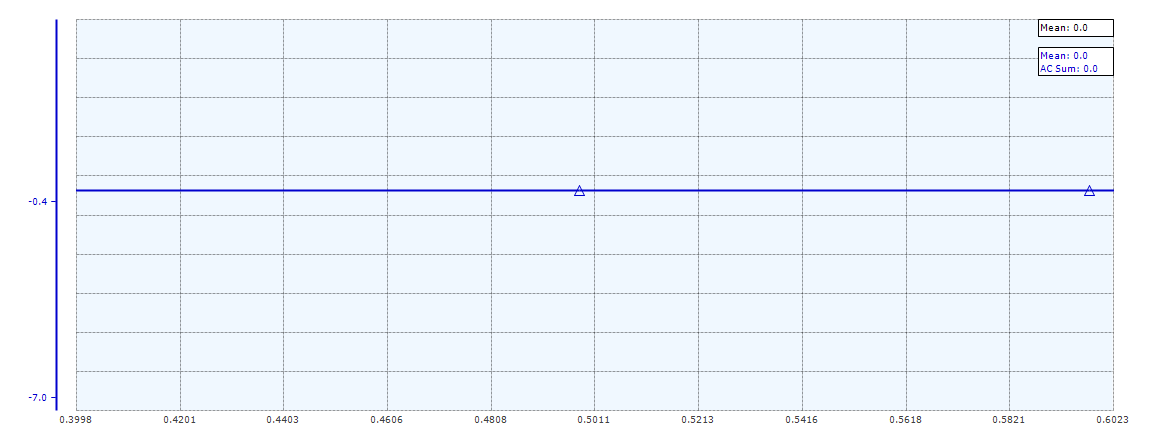

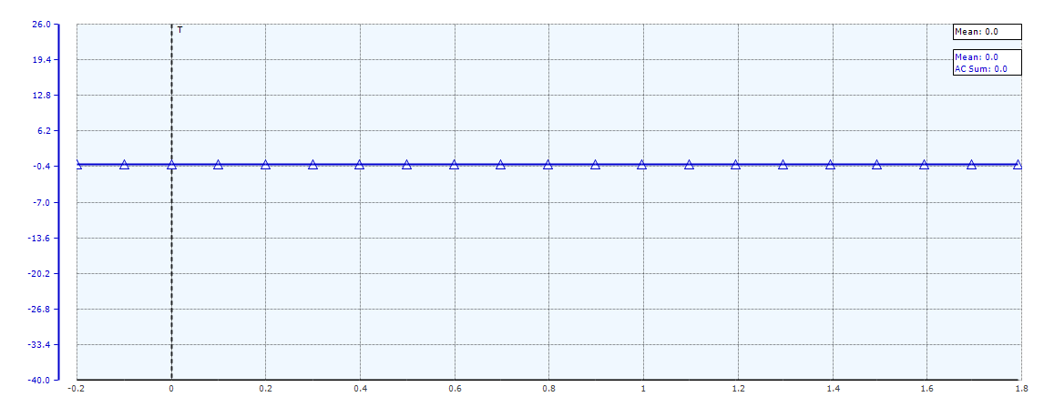

Up until now, I handled zooming using the middle mouse scroll. But now I've added support for your default zoom tool (click-and-drag rectangle).
I'm using the Zoomed and UndoneZoom events to re-apply the Y-axis labels, and the events do fire correctly. However, after zooming, the labels appear corrupted — even though debugging confirms they are being set as expected.
I've attached two images:
Before zoom: Y-axis shows 11 labels (as intended).
After zoom: Even though I reset the labels to 11, the axis doesn't render them correctly.
Any idea what could be causing this?

Hello TomAgos,
Could you check whether your axis.Increment is set at 0 (automatic)? If so, try assigning a value that better fits your scenario.
If adjusting the Increment value doesn't resolve the issue, please share the code that triggers when zooming. I haven’t been able to replicate the problem naturally on my end, so testing your specific implementation would help me investigate further and assist you more effectively.
Please let me know if this helps or if you need any further assistance. I’ll be happy to look into it!
