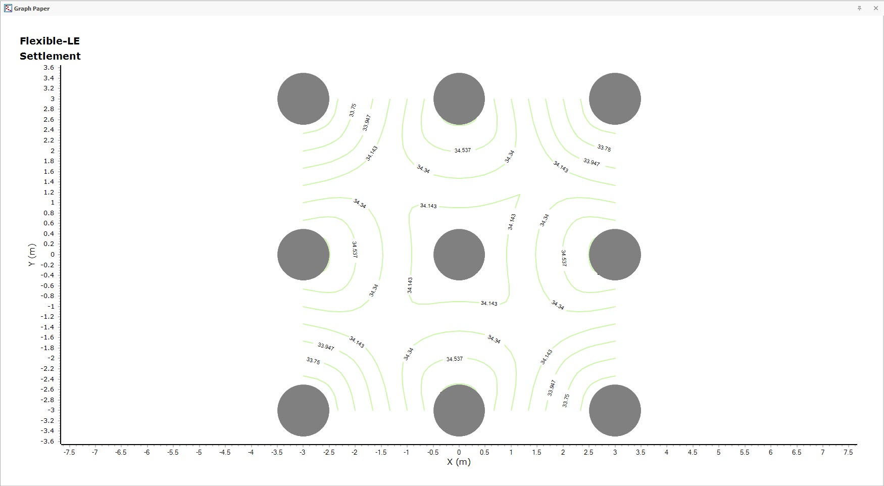

I am trying to create a contour graph that uses ISO axes (i.e. the same X and Y scales) AND has a number of circles drawn on top of it. Screenshot #2 (correct) below shows the graph I am trying to produce.

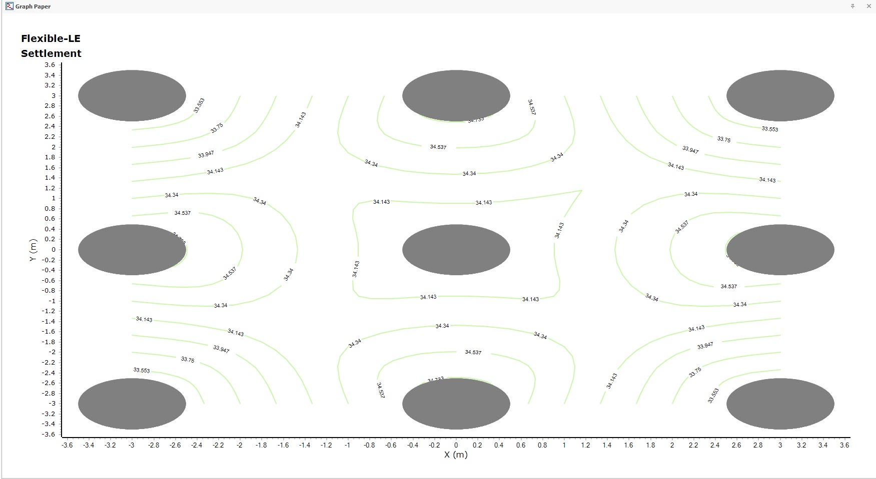

The problem is that, when the graph first appears, the axes are not scaled properly, as shown here:
Screenshot 1 (wrong).jpg (127.84 KiB) Viewed 4855 times
I have put the code that adjusts the scales AND draws the circles is the chart's AfterDraw event handler:

The strange thing is the WRONG drawing displays the circles, so has clearly gone through the AfterDraw event.
It is only when I move the mouse over the drawing that the graphs flashes and then displays the CORRECT drawing, without going through AfterDraw a second time.
Can anyone please explain what is happening here? What am I missing?

Hello Andrew,
This probably happens because the MakeIsoAxis function changes the axes scales but doesn’t redraw the chart, so the changes only take effect the next time the chart is drawn.
To fix this, you likely just need to force a chart redraw by calling Draw() at the end of your FormCreate event or a similar initialization routine.

Thanks, Yeray, that worked
