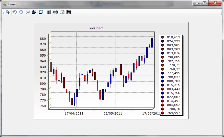

Using next code and last version of TeeChart.Net it works fine for me, so the bug with number TF02012194 is fixed:
            InitializeChart();
        Steema.TeeChart.Styles.Candle Series1;
            Series1 = new Steema.TeeChart.Styles.Candle(tChart1.Chart);
            Series1.FillSampleValues();
            Series1.DownCloseColor = Color.Red;
            Series1.UpCloseColor = Color.Blue;
And achieve next image:
Could you tell us which version are you using now?
