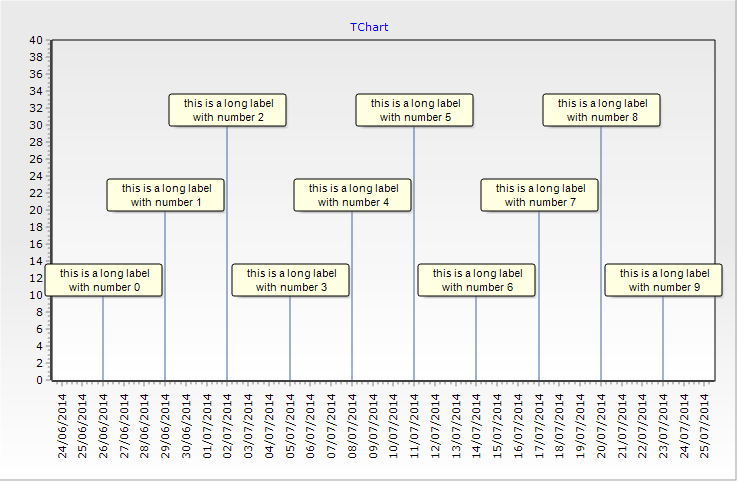

Post by mivtee » Wed Jun 25, 2014 3:36 pm
is it possible now to create a timeline?
Re: Timeline charts
Post by Yeray » Thu Jun 26, 2014 8:30 am
I'm afraid there isn't a series to directly draw this, but it wouldn't be difficult to use the existing series to achieve a very similar result. Ie:
uses CandleCh, DateUtils;
var i: Integer;
    tmpDate: TDateTime;
  Chart1.View3D:=false;
  Chart1.Legend.Visible:=false;
  tmpDate:=Today;
  with Chart1.AddSeries(TVolumeSeries) as TVolumeSeries do
    Marks.Visible:=true;
    XValues.DateTime:=true;
    for i:=0 to 9 do
      AddXY(tmpDate, 10*((i mod 3)+1),'this is a long label'+sLineBreak+'with number '+IntToStr(i));
      tmpDate:=IncDay(tmpDate, 3);
  Chart1.Axes.Left.SetMinMax(0,40);
  Chart1.Axes.Left.Grid.Visible:=false;
  Chart1.Axes.Bottom.Grid.Visible:=false;
  Chart1.Axes.Bottom.LabelsAngle:=90;
  Chart1.Axes.Bottom.Increment:=1;
  Chart1.Axes.Bottom.MinimumOffset:=50;
  Chart1.Axes.Bottom.MaximumOffset:=50;
