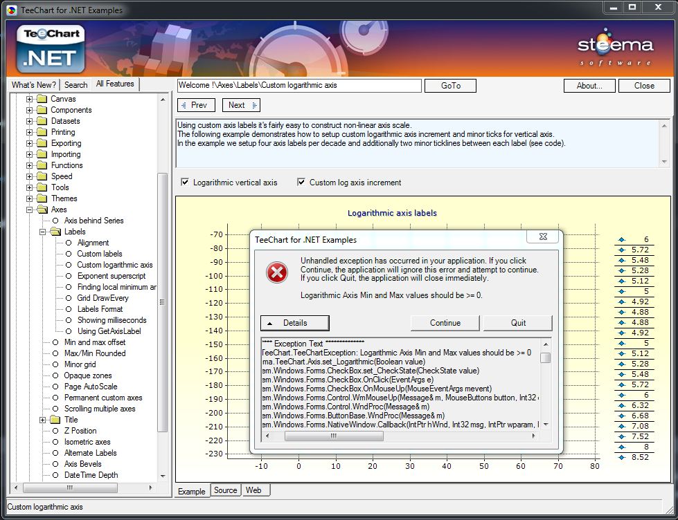

Exception details:
Steema.TeeChart.TeeChartException: Logarithmic Axis Min and Max values should be >= 0
at Steema.TeeChart.Axis.set_Logarithmic(Boolean value)
at Steema.TeeChart.Samples.Log_CustomIncrement.checkBox1_CheckedChanged(Object sender, EventArgs e)
at System.Windows.Forms.CheckBox.OnCheckedChanged(EventArgs e)
at System.Windows.Forms.CheckBox.set_CheckState(CheckState value)
at System.Windows.Forms.CheckBox.OnClick(EventArgs e)
at System.Windows.Forms.CheckBox.OnMouseUp(MouseEventArgs mevent)
at System.Windows.Forms.Control.WmMouseUp(Message& m, MouseButtons button, Int32 clicks)
at System.Windows.Forms.Control.WndProc(Message& m)
at System.Windows.Forms.ButtonBase.WndProc(Message& m)
at System.Windows.Forms.Control.ControlNativeWindow.OnMessage(Message& m)
at System.Windows.Forms.Control.ControlNativeWindow.WndProc(Message& m)
at System.Windows.Forms.NativeWindow.Callback(IntPtr hWnd, Int32 msg, IntPtr wparam, IntPtr lparam)
I ran across this issue in my application. It can be easily duplicated in the sample project, TeeChart for .NET Examples, you provide.
1. Go to Welcome !\Axes\Labels\Custom logarithmic axis
2. Use the right mouse button to pan the chart to the right so the bottom axis minimum shows -20
3. Uncheck the "Logarithmic verticle axis" checkbox
4. Check the "Logarithmic verticle axis" checkbox and you get the exception.
In my application this was causing the application to crash, I had to catch the exception and handle it.

I am using version 4.1.2012.09280. I'm running the pre-built .net Features Demo.
1. Bring up the Custom logarithmic axis demo.
2. Uncheck Logarithmic vertical axis.
3. Slide the chart up to reveal negative numbers in the vertical axes.
4. Check Logarithmic vertical axis.
Brian
