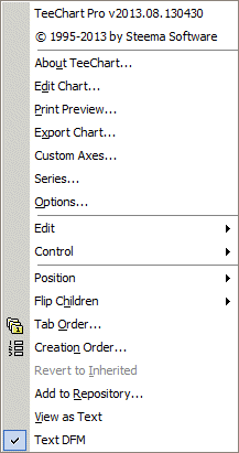

Position the mousepointer over the new Chart and press the right mousebutton. A menu appears that includes the ‘Edit Chart’ option.
Fig. 1. Using the right mouse button on the Chart will call the Chart options menu. | ![]() |
Select the Edit Chart… option to edit the Chart and define and populate its data Series.
