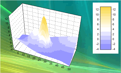

Backimage
You can add more information to your Chart or simply enhance its appearance by adding a bitmap as a backdrop.
Bitmap as a Chart backdrop
You will find the parameters to define your Chart backdrop in the General tab of the Chart page of the Chart editor.
