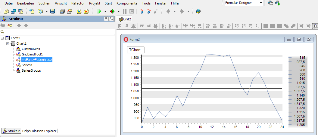

I'm confused. The cursor tool is a regular component, just like the chart itself, a button or whatever. You can rename it to whatever you like:
This also enables you to use this reference in code (like "myFancyFadenkreuz.Active := checkItsRainingOutside();") without having to introduce another variable or do any casting.
