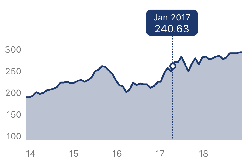

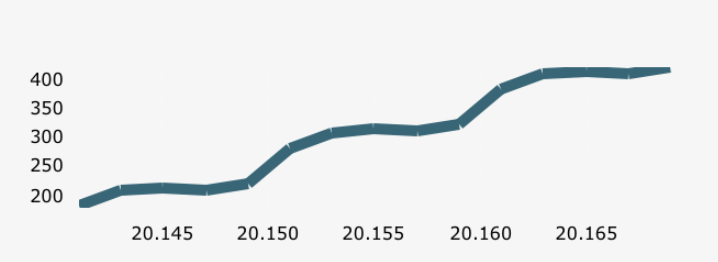

Any pointers on how to get my current line graph
Screen Shot 2018-04-20 at 14.38.34.png (34.8 KiB) Viewed 21390 times
Looking more like
Screen Shot 2018-04-20 at 14.40.31.png (46.02 KiB) Viewed 21391 times
Some questions:
1. Somehow I still see the marks on the line of the cross sections, so the line is not 1 smooth full color line
2. How do you enable the color fill from the bottom axes to the line?
3. Is there any graph touch interaction possible on the xamarin forms version, so that the user can move it's finger over the graph and we show a label at the mark selected?

The github code is working great!

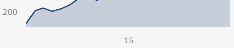

Only 1 small question still... if you look at my sample image, you will notice a 15 at the bottom.
This because I added DateTime values for the graph and set the Bottom Axes as follows:
AreaLineChart.Chart.Axes.Bottom.Increment = Steema.TeeChart.Utils.GetDateTimeStep(DateTimeSteps.OneYear);
AreaLineChart.Chart.Axes.Bottom.Labels.DateTimeFormat = "yy";
Now my question, although I increment per Year, the data also contains 2014 values. Can I make sure the left lower corner also has 14 visible?

Post by Pep » Fri Apr 27, 2018 1:51 pm
Hi Glenn,
some options here :
One way would by trying to add an extra offset for the bottom axis minimum and maximum :
chart.Axes.Bottom.MinimumOffset = 100;
If this doesn't help, you can also add custom axis labels manually , please take a look at the following post, and in the case you still having problems let me know, so we can try to find a solution :
http://www.teechart.net/support/viewtopic.php?t=8392

Awesome, bottom.MinimumOffset and MaximumOffset does the trick, thanks!
