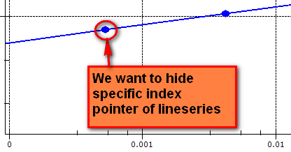

Is it possible to hide the pointer of specific index in line Series. Meaning that if a line series contains 5 pointer but we want to show 1,2,3,5 index pointer only and want to hide index 4 pointer.
Please find attached image showing that pointer we want to hide.
Hide pointer
hiding pointer.png (9.71 KiB) Viewed 5290 times
like:- line1.pointer[0].Visible=false;(We are thinking like that).
please provide any solution asap.

Hi PlanoResearch.
Check out the GetPointerStyle event at Tutorial 6 - Working with Series. You just need to set your desired points to Steema.TeeChart.Styles.PointerStyles.Nothing.
