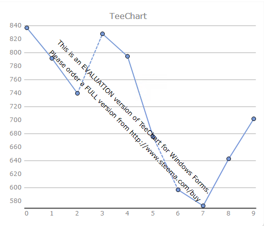

In this particular case, I think the GetPointerStyle is not the best event to use—if you use the BeforeDrawPoint event you will obtain the results you expect:
Screenshot from 2022-09-02 12-25-28.png (34.58 KiB) Viewed 7831 times
This is because the GetPointerStyle is specific to the pointer, and in the source-code is called after the line is drawn.
