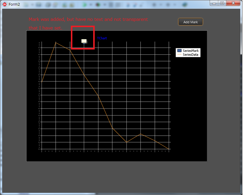

Post by elmec » Mon Dec 23, 2013 7:40 am
I want to add Marks at some index of series, but failed..
please help me!
Find the attachment for the example project!
Add mark.png (58.97 KiB) Viewed 26634 times
AddMarks.zip
(95.97 KiB) Downloaded 945 times
Posts: 9671
Re: Failed to add Marks manually
Post by Yeray » Mon Dec 23, 2013 11:19 am
Looking at your project, you have two series, named SeriesMark and SeriesData. Only SeriesData has points:
__fastcall TForm2::TForm2(TComponent* Owner)
	: TForm(Owner)
	// Data series
	SeriesData->FillSampleValues(10);
Then, the button does this:
void __fastcall TForm2::Button1Click(TObject *Sender)
	double max = Chart1->LeftAxis->Maximum;
	// Mark sereis which is used to show some mark.
	SeriesMark->Marks->Visible = true;
	SeriesMark->Marks->Transparent = true;
	// Tried to add a mark at index of 3 .
	SeriesMark->AddXY(3, max);
	SeriesMark->Marks->Item[3]->Text->Text = "N";
So you are adding a single point to the SeriesMark series, and then accessing to the point with index=3 to set its label.

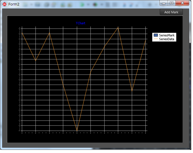

Thanks for your reply.

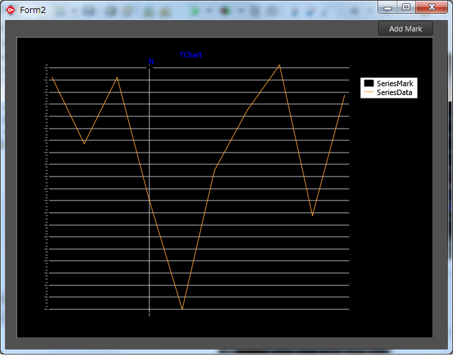

I know that the mark could be added directly by the code below,
but the grid also disapeared...
SeriesMark->AddXY(3, max, "N");
So I have tried to use the following code to modify mark manually.
But it didn't work well...
In the case you want to continue displaying all the axis grid lines and bottom axis labels you have to set the bottom axis style to Value :
  Chart1.Axes.Bottom.LabelStyle := talValue;

yes, a workaround would be to set the axis label style to "talValue", like :
procedure TForm1.BitBtn1Click(Sender: TObject);
var max : double;
   max := Chart1.LeftAxis.Maximum;
   Series1.AddXY(3, max);
   Series1.Labels.Labels[0]:='N';

as you can see at the bug resolution, it was my mistake when I say you were correct about the issue. It's not a bug. As you only have added one point to the Series, to be able to set a specific mark text for that point you have to use the 0 index for the item, like :
	SeriesMark->Marks->Item[0]->Text->Text = "N";
        SeriesMark->Marks->Item[0]->Font->Size=18;

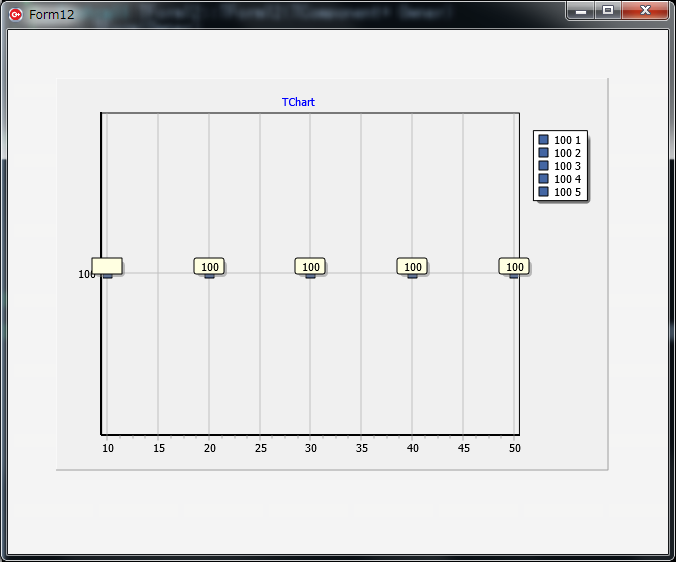

OK , I'd like to repeat the problem again.
---------Code-----------
	Series1->Marks->Visible = true;
	// Add 5 points to Series
	int xpoints[5] = {10, 20, 30, 40, 50};
	int y = 100;
	for (int i = 0; i < 5; i++)
		Series1->AddXY(xpoints[i], y, IntToStr(i + 1));
	Series1->Marks->Item[0]->Text->Text = "test";
But the result is as the attachment! There is no text on mark!
Pep
Posts: 3316
Post by Pep » Wed Jan 22, 2014 12:04 pm
Hello elmec,

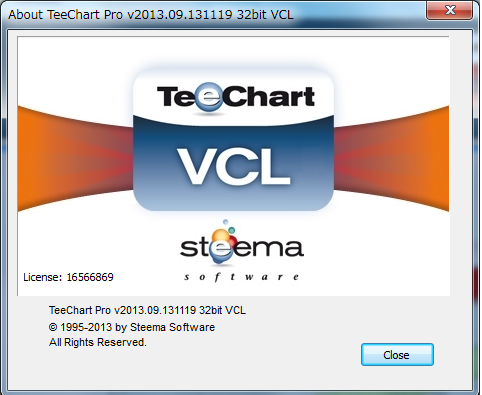

It's strange, it's working fine here with the latest TeeChart Pro v2013.09.131217 version usign the code you posted.
Could you please check which TeeChart version appears into your About box ?
elmec
Posts: 129
Post by elmec » Thu Jan 23, 2014 12:33 am
Hello Pep,
Find the attachment for the Teechart version and example project.
