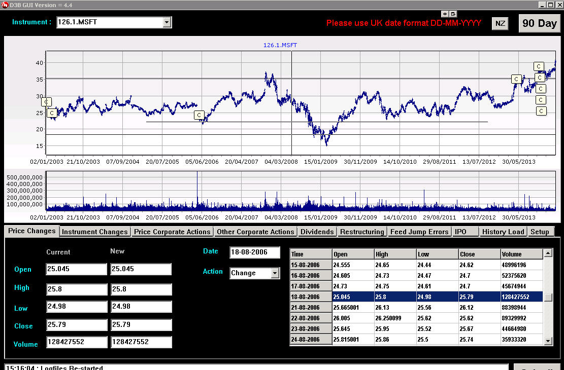

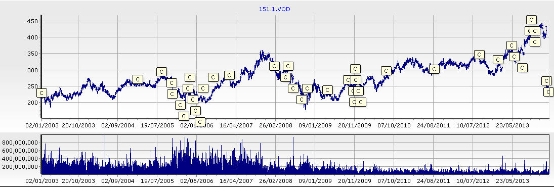

I have a candlestick chart which users use to view and correct financial data (pls see attached jpg). The Marks on the chart show where there are corporate actions 'C' or name changes 'N'. I currently use cross hairs and allow users to click and drag a rectangle to zoom into the chart to see the candle bars in more detail and then when a candle is clicked on using the OnClickSeries event I display the candle data for a user to edit.
What the users are asking for is when they click on a candle for a vertical line to be drawn on the chart so they can easily see where they have clicked. They also want this line to move when they click on another candle - all this needs to happen without losing any of the existing functionality.
I have read the various posts and tried a number of different things and none of these seem to display a vertical line and I wondered if you could help.
The final question from the users is its quite tricky to actually click on a candle so can they click anywhere on the chart and pickup the candle above or below where they click.
Many thanks
Barry

Sorry - I clearly have not made a very good job of explaining what I am after, but the demo you sent me is very helpful as it allows me to explain better.
If you run your demo and then select Editor then
Tools -> Color line - > Options and click "allow Drag" (I also made mine Red so I could see it better)
Now you can drag it left and right, what I want is the values in the string grid to change as I drag the color line over them - as it stands I still have to click on the Candle - This is already build into my code and I know how to do this, pls see the better screenshot
