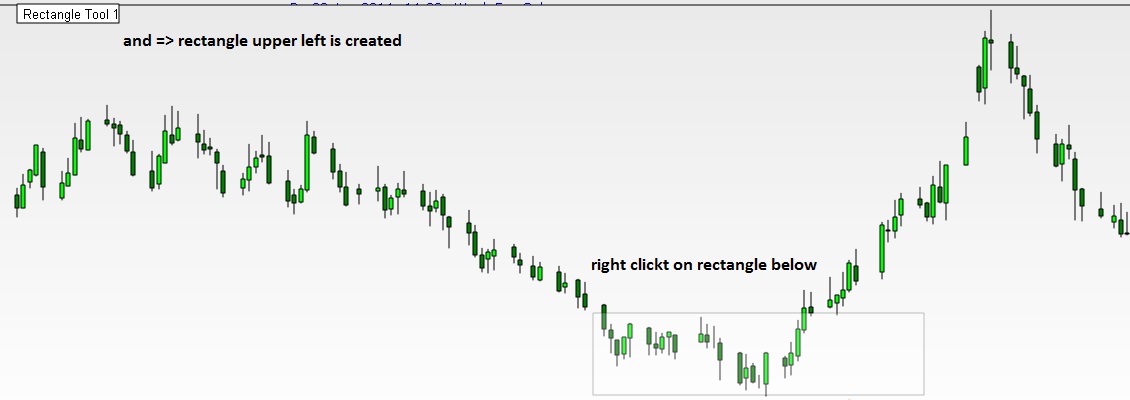

Re: Charttool TRectagleTool - Copy!
thank you for your reply.
Then the reason should be this: I have no button, which is clicked.
I do want to click the rectangle itsself. So I would need a mouse over or so.
But mouse move I cannot use, because it is taken for "big candle".
I want to use a context menu for the rectangle-copy-tool and a right click of the mouse.
In other words I would need this:
- recognize, that the pop-up-menu is clicked (I can to this by myself and land in the code of a method)
- find out, over which rectangle the mouse cursor is placed (I cannot do this)
- use the parameters of this "found" rectangle (I cannot do this) to copy it
- place the new rectangle in a way, that it is visible on the chart (so either above or below, right of left, depending)
Cheryll
Hi Cheryll,
I think you just have to make the new TRectangleTool to use the same OnClick event than it's "parent".
This is the new code for a simple example:
I only added a line of code to the example I posted above.
with Chart1.Tools.Add(TRectangleTool) as TRectangleTool do
Text:='Rectangle Tool 1';
AutoSize:=true;
Shape.Transparency:=0;
Left:=100;
Top:=75;
OnClick:=RectClick;
procedure TForm1.RectClick(Sender:TAnnotationTool; Button:TMouseButton; Shift: TShiftState; X, Y: Integer);
if Button=mbRight then
Text:=Sender.Text + ' (twin)';
AutoSize:=Sender.AutoSize;
Shape.Transparency:=Sender.Shape.Transparency;
Top:=Sender.Top+Sender.Height;
Left:=Sender.Left;
OnClick:=RectClick;

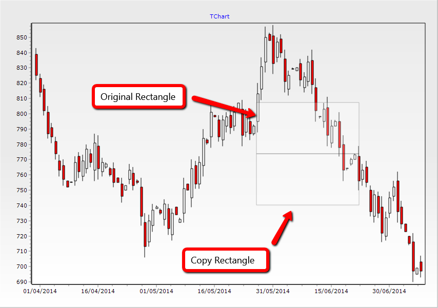

this brings me a huge step further.
A nice rectangle is created without errors.
Sorry for not being able to do it:
How can I manage, that is has the same size and style as its origin?
I tried something with height and width, but nothing worked.
I attach you a screenshot of the origin and new rectangle, which I see.
I wanted the new one (which looks similar to a balloon hint in our screenshot example) looking alike the old one.
Cheryll
Cheryll
- creation works without errors.jpg (55.33 KiB) Viewed 10895 times
Cheryll
