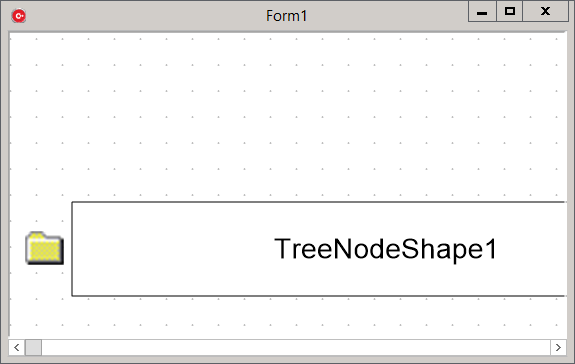

Here's an example. All I have to do is just drop a TeeTree in to a form. Double Click on the TeeTree and add a Rectangle. Click on Zoom. THe Rectangle will change in size but the text within the Rectangle will not change in size.

The project you posted above looks like this in XE6 and TeeChart v2014.11 for me here. Doesn't it for you?
