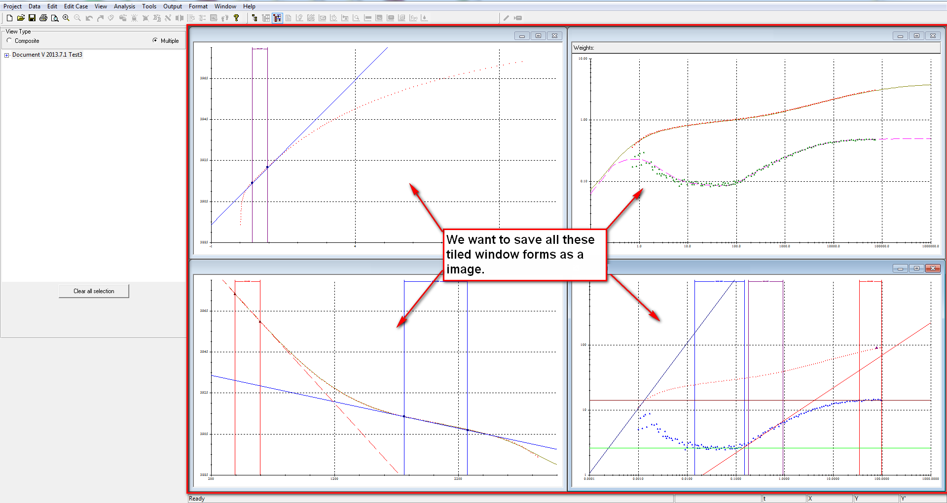

Hi Steema,
We want to save the single image of Multiple opened charts in different tiled windows as shown in image. as shown in attached image
Save Image of Multiple Chart
save as image.png (135.54 KiB) Viewed 15607 times
Please provide any solution asap.

Re: Save Image of Multiple Chart
Post by Christopher » Fri Oct 31, 2014 11:52 am
Hello!
This isn't really a TeeChart issue per se, as TeeChart is perfectly capable of exporting itself to an image.
If you want to combine two (or more) images to one image, you can create a new bitmap then paint each image onto it. First create a bitmap at runtime, then create the graphics from the image and then use this graphics to draw your images to it.
Post by Christopher » Thu Nov 13, 2014 2:52 pm
amol wrote: A demo project is attached of above mail. Please find.
This seems to be a limitation of the Control.DrawToBitmap Method:
The DrawToBitmap method is not supported for ActiveX controls. You can override the OnPrint event and provide custom printing logic if required.
The DrawToBitmap method has the following limitations:
An ArgumentException might be thrown for large bitmaps. The maximum allowable size varies by machine.
DrawToBitmap does not support the Ink controls for the Windows XP Tablet PC Edition 2005 operating system.
DrawToBitmap does not draw a child TextBox if the Visible property of the TextBox is set to false.
Controls inside containers are rendered in reverse order.
DrawToBitmap is not fully functional for the RichTextBox; only the border of a bitmap is drawn.
If DrawToBitmap cannot even render Microsoft's own controls such as RichTextBox, then I'm afraid it doesn't surprise me that TeeChart is not being rendered.
Post by Christopher » Fri Nov 14, 2014 9:26 am
amol wrote: Please provide me the solution for that.
I think I have already suggested a solution to this issue in my post here:
The issue with TeeChart not rendering to a Panel's bitmap is a Microsoft issue, not a Steema issue, I'm afraid.
