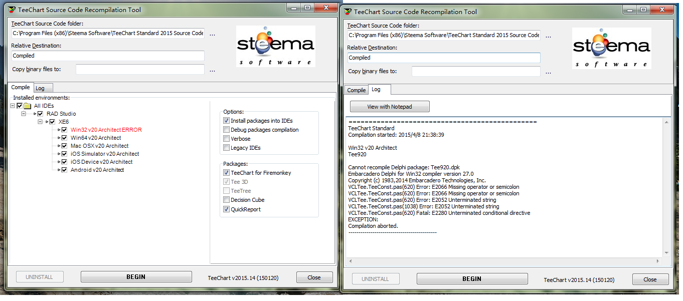

my os is windows 7 x64,and the development tool is delphi xe6
and i buy the TeeChart Pro v2015 VCL / FMX
but i run teerecompile.exe
the error appears
how to install
thanks

Re: help,how to install in delphi xe6
Have you modified TeeConst.pas before running TeeRecompile?
Note SourceCode customers can access the binary installers too, and we use to recommend installing the binary version before the source code version because only the binary version includes the examples and documentation.
First of all note both your screenshots and your license seem to indicate you bought TeeChart Standard with SourceCode, not TeeChart Pro with SourceCode.wangchb wrote:and i buy the TeeChart Pro v2015 VCL / FMX
I've installed TeeChart Standard with SourceCode and I've ran TeeRecompile against RAD Studio XE6 and it ended without errors:wangchb wrote:but i run teerecompile.exe

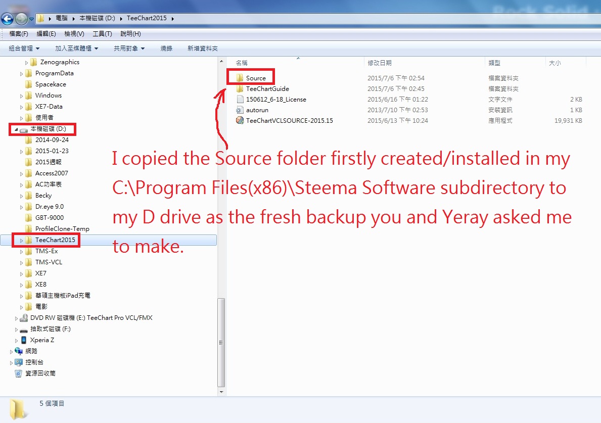

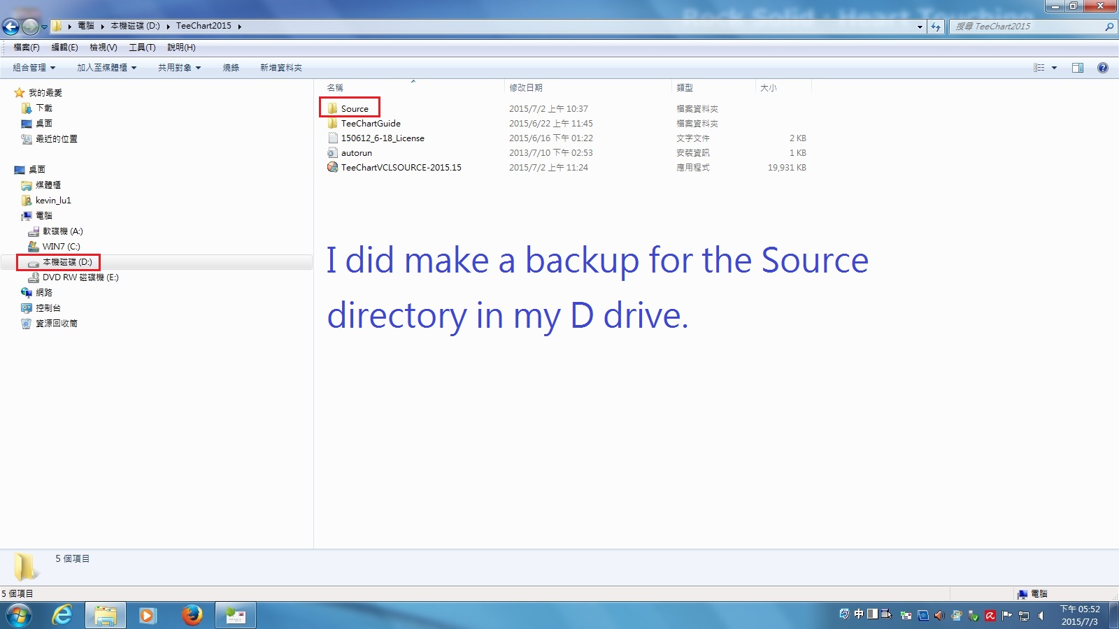

Hello Narcis,
I did make a backup in my D drive for the source folder, please see the attached picture. Must I put that backup in a specific location?
What else can be the reason that caused those failure and errors in my Teechart installation?
Hi Drinker,
You should replace the Sources folder in the TeeChart installation and which is being used by the TeeRecompile for the backed up folder and try running TeeRecompile again.Drinker wrote: Must I put that backup in a specific location?
Such errors use to occur when TeeRecompile failed to finish its work successfully and can not restore the Unicode converted language and constant files to their original ANSI format.Drinker wrote: What else can be the reason that caused those failure and errors in my Teechart installation?![]()
Hello Narcis,

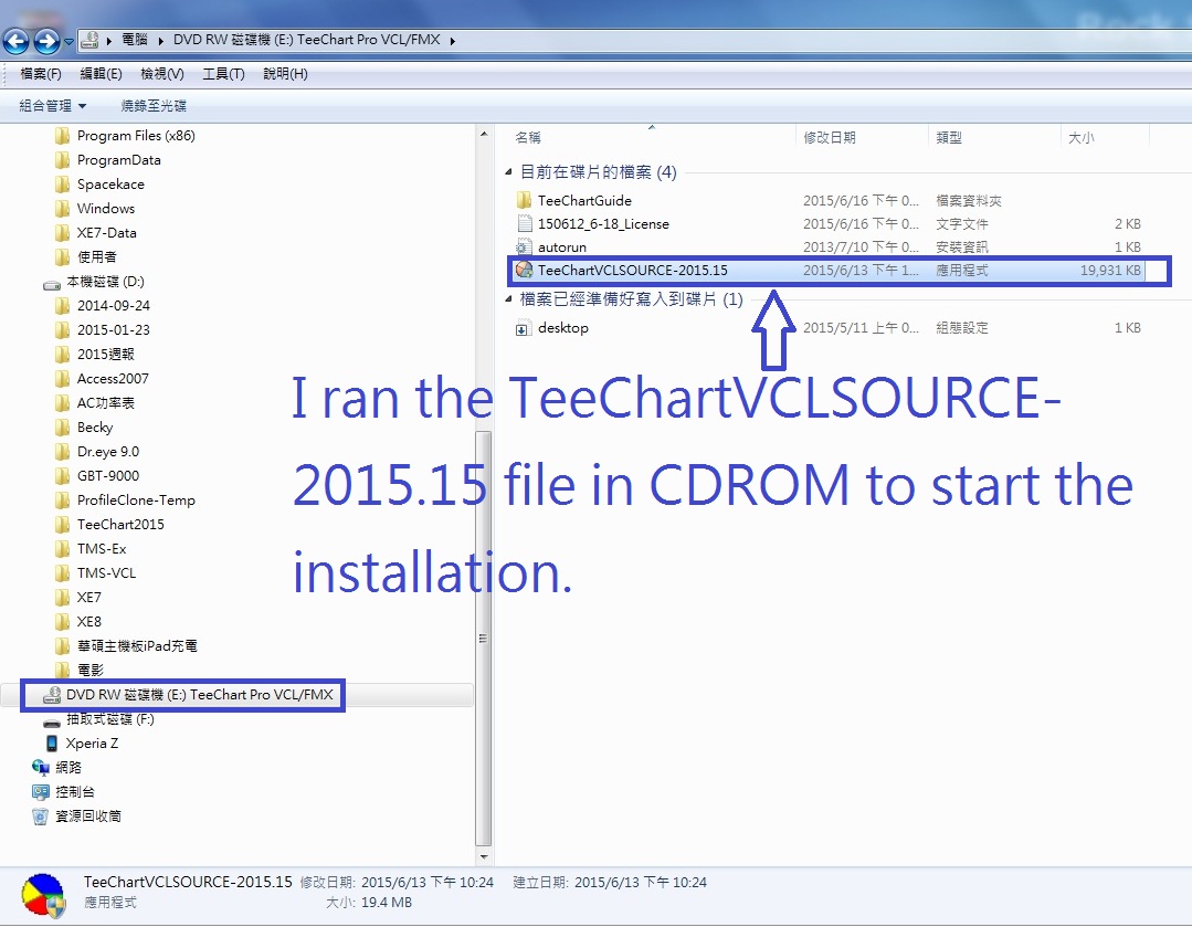

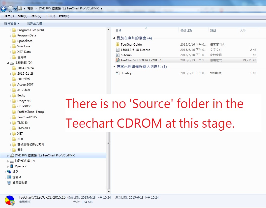

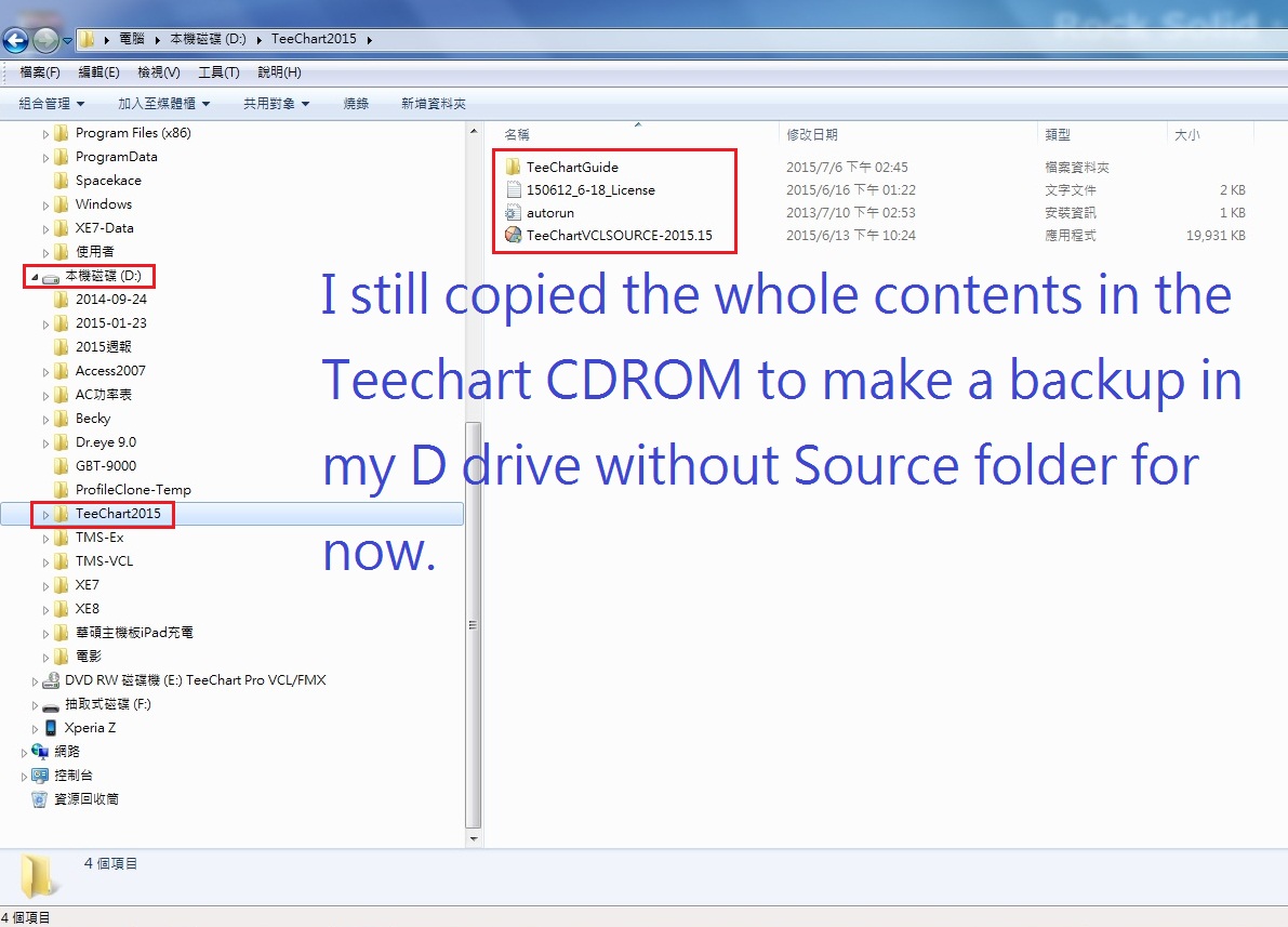

I tried the installation again according to the notes you gave last Friday; however, the result is still the same. I think I had better show you the detailed procedures of my installation and hopefully you can check my installation procedures and tell me where went wrong and caused the installation failures.
Step1: There is no such a source folder in the Teechart CDROM at this phase(see pic1.) Step2: I still copied the whole contents from the Teechart Pro CDROM I bought to make a backup in my D drive without the ‘Source’ folder you and Yeray mentioned (see pic2.) Step3: I ran the TeeChartVCLSOURCE-2015.15 file in CDROM to start the installation (see pic3.) It seems that I can upload only 3 pictures in a post, so I will continue my further steps in my next post.

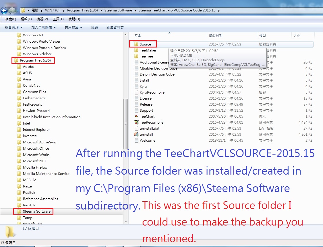

Hello Narcis,
I will continue my unfinished installation steps in this post:
Step4: After running the TeeChartVCLSOURCE-2015.15 file in CDROM, the Source folder was created/installed in my C:\Program Files (x86)\Steema Software subdirectory. This was the first Source folder I could use to make the backup you mentioned (see pic4.) Step5: I copied the Source folder being created in my C:\Program Files (x86)\Steema Software by running the file TeeChartVCLSOURCE-2015.15 to my D drive as the backup before doing anything else just like what you and Yeray said (see pic5.) Step6: Then I ran the TeeRecompile and got the fist same failure result.
Step7: Then I copied the fresh backuped Source folder from my D Drive to replace the Source folder being created/installed in my C:\Program Files (x86)\Steema Software.
Step8: Then I ran the TeeRecompile again and got he same failure result again (see pic6.) Since I have done what you and Yeray asked and still got the same failed result, would you please help me to check my installation procedure thoroughly to see where went wrong and provide me a specific, detailed installation guidance, not just one or two short and vague sentences. Thanks.

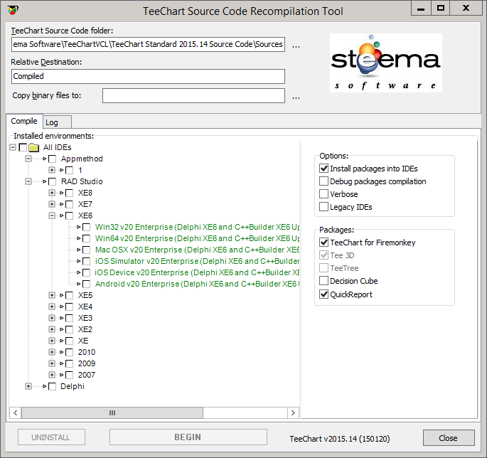

Thanks for the detailed information.
First, I'm a bit confused because you mention RAD XE7 twice in a post earlier:
So, the first question would be, are you running TeeRecompile against RAD XE7 or RAD XE8?
On the other hand, I see you are in a Chinese OS, is that right?
We'll do some tests here with the same OS and RAD Studio version you have.
However, in one of the images you've posted now, TeeRecompile seems to be compiling the packages for RAD XE8:Drinker wrote:I am trying to install Teechart 2015.15 in XE7 and having the same E2066, E2052 and E2280 errors:
The IDE I am using is Embarcadero C++Builder XE7.

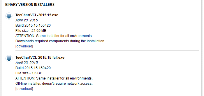

You mentioned that I should also have access to the binary installer.
I tried to find the binary installer on your website but couldn’t find it; could you please upload a screen shot to show me where on your website I can access the binary installer?

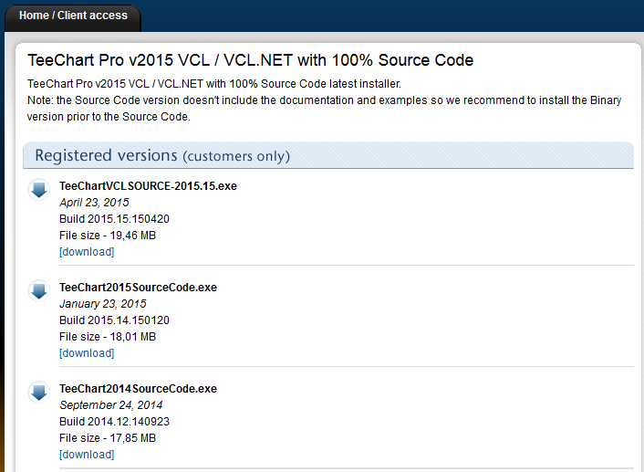

Hi Drinker,
If you scroll down, there's a moment where the source code installers finish and there starts the list of Binary installers available:
Logging in the client area with a Source Code license gives you a list of downloads. It starts like this:Drinker wrote: You mentioned that I should also have access to the binary installer.
