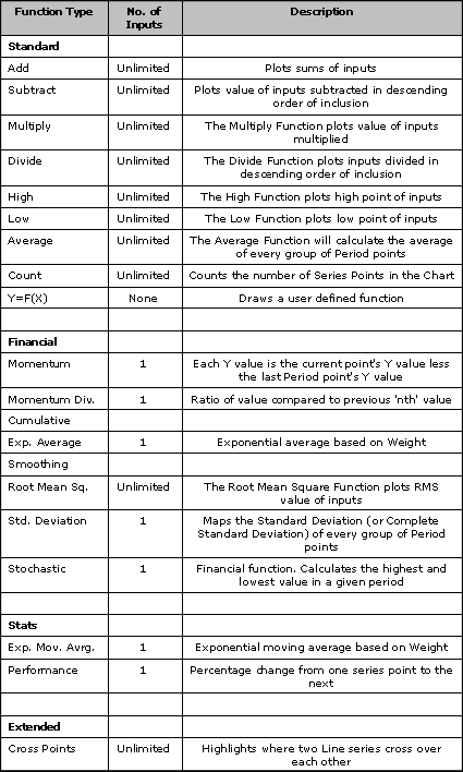

Function Types
Function characteristics A TeeChart Pro Function is a Series, that can be of almost any Series Type, to which an algebraic function is applied and for which the datasource is another Chart Series.
All Functions derive from the Function Class in the Steema.TeeChart.Functions namespace and inherit Function's Period property. TeeChart Pro offers following list of predefined functions:
Several Function types support only one input Series. However it is possible to chain link Functions, thus, for example, taking the average of several Series in your Chart to create an Average Function Series, then identify the Trend of the average by using the Average Function as the input to the Trend Function.

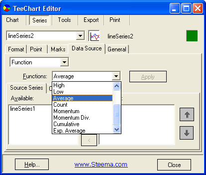

With the TeeChart Editor, on the First Chart page, select the Add button as if to add a new Series to the Chart. In the TeeChart Gallery choose the Functions tab to select the Function you require. Each Function is presented as a Line Series, you may change the Series Type associated with the Function later by choosing the Change button on the first Chart Page. Function definitions are easily changed afterwards on the Datasource page of the Function Series. Here, just as easily, you may change the definition of a normal Series that you have added to the Chart to that of a Function (Function is really a definition of datasource, not a definition of Series Type).
The image below shows the Datasource page when editing a Function. The Line Series (Title "line2") is defined. The left listbox at the bottom of the Datasource page shows other Series in the Chart available for input (here "line1").

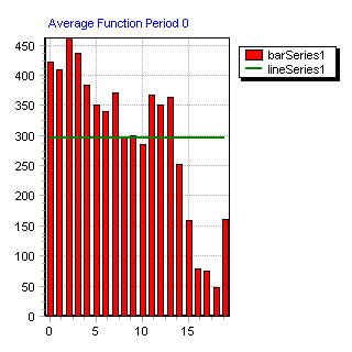

We define a Function Series with Period 0 (default) the average drawn is:
6.667

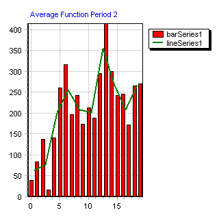

With Period set to 2 we get 3 values of average as output from the function:
5.5, 4 and 10.5
These values will plot centrally in their period range, i.e. The 1st value between bars 1 and 2 of the input series, 2nd value between bars 3 and 4, etc..

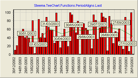

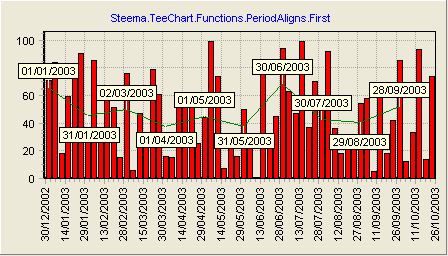

Period = Month.TotalDays and PeriodAligns.First
As you can see from the picture below, the "average" is plotted at the end
of the month.
Period = Month.TotalDays and PeriodAligns.Last
In this case the "average" is plotted at the beginning of the month.
